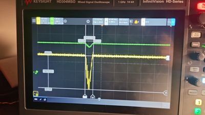

We re-examined the current issue and found that the power supply problem is indeed more significant. However, the original oscilloscope truly couldn't detect any anomalies. Therefore, we borrowed a higher-end oscilloscope, and the test results were excellent! Although we didn't capture the voltage level during the reset event, we did successfully capture waveform dips at certain moments!
The voltage dropped to around 2.8V. Although it didn’t reach the BOR  threshold, this is very likely the root cause of the issue!
These things can, indeed, be hard to spot - the pulses can be narrow and infrequent.
Well, the one you captured didn't.
You need to check what happens in a worst-case scenario - probably when the battery is low, and the solar cell isn't charging.
Again, does your system log the battery state-of-charge?
BTW: Please use your scope's screen capture facility - it will be much better that photos of the screen!

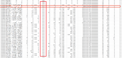

---> Yes, but at that time the battery voltage was still quite high. 4.0~4.2V .
These are the monitoring logs from several devices on the platform.

Yes, the 4G module manufacturer specifies a peak current requirement of 1 A. Our battery is capable of up to 20C discharge (1000 mA), but the LDO can only supply 200 mA, and the output capacitance is also very small...
Do you write to flash on the devices? This has a large current requirement so the drop could be happening there. 37ms is a long time though. Should be able to capture that on any scope.

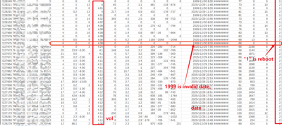

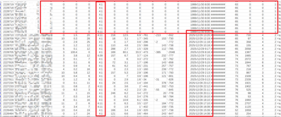

It is now confirmed that there is a power supply issue, which under certain conditions can cause the device to reboot. Moreover, it is highly likely that such a reboot occurs concurrently with a Flash write operation.
Summary of the observed behavior:
A device may suddenly start rebooting sporadically (low-probability reboots), confirmed to be caused by the power supply issue.
There was a device that initially rebooted infrequently (low-probability reboots), but at a certain point, its reboot frequency suddenly increased significantly (high-probability reboots). It was also confirmed that reading the Flash memory of this device using STM32CubeProgrammer resulted in errors.
Another device exhibiting high-frequency reboots stopped rebooting after its Flash was fully erased and the firmware was re-flashed (it may still experience low-probability reboots, but this has not been reproduced yet).
