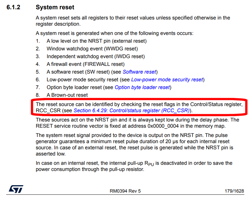

The STM32L4 has three types of reset: system reset, power reset, and backup domain reset.
  • Power reset → 3.3V is OK; Standby and Shutdown modes are not used.
  • System reset could be caused by:
    1. A low level on the NRST pin (external reset) → No external reset signal was captured by the oscilloscope.
    2. Window watchdog event (WWDG reset) → Not enabled.
    3. Independent watchdog event (IWDG reset) → Not enabled.
    4. A firewall event (FIREWALL reset) → Not enabled.
    5. A software reset (SW reset) (see Software reset) → HAL_NVIC_SystemReset() was not called.
    6. Low-power mode security reset (see Low-power mode security reset) → Not enabled.
    7. Option byte loader reset (see Option byte loader reset) → Not enabled.
    8. A Brown-out reset → 3.3V is OK.
  • Backup domain reset could be caused by:
    1. Software reset triggered by setting the BDRST bit in the Backup domain control register (RCC_BDCR) → HAL_RCC_BackupResetCmd() or similar was not called.
    2. VDD or VBAT power-on, if both supplies had previously been powered off → 3.3V is OK.
So, why did the reset occur?
Read the flags in RCC_CSR to determine the cause of the reset.
If only PINRSTF is set, the NRST pin is being pulled low externally, probably by the external supervisor.
The RCC_CSR will tell you that:
https://www.st.com/resource/en/reference_manual/rm0394-stm32l41xxx42xxx43xxx44xxx45xxx46xxx-advanced-armbased-32bit-mcus-stmicroelectronics.pdf#page=179

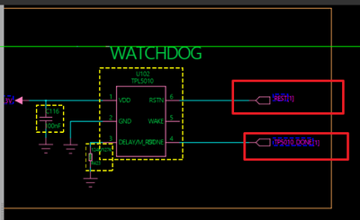

It is unlikely that the TPL5010 caused the reset, for the following reasons:
  1. The watchdog timeout configured via external resistors on the TPL5010 is set to 1 hour.
  2. The watchdog is being regularly fed—the feeding signal has been confirmed by oscilloscope measurements.
  3. If the reset were triggered by the TPL5010, the low pulse on the nRST pin should last significantly longer than 1 ms (the TPL5010 datasheet specifies a typical reset pulse width of 320 ms). However, actual measurements show that the low-level duration on the nRST pin is less than 1 ms.

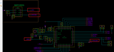

What if the problem is not within the code? Code doesn't start behaving differently after 10-20 days, barring rare scenarios like a timer overflow or slowly depleting heap. The code you showed doesn't have either of those. The cause is likely something external to the chip.
We initially suspected an external issue as well. After conducting a series of tests, we confirmed that both the power supply and the reset circuitry are functioning correctly.
Given that, are there any other external I/O pins that could potentially cause the MCU to reset? For example, could the SWD pins be a factor? The SWD I/Os are left floating—could that affect system stability or trigger a reset?
