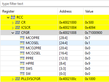

I have a small problem understanding the timer 16 of the STM32G030K6T6 microcontroller. According to the data sheet, it should use the TIMPCLK clock, which corresponds to the PCLK clock.
My system clock is supplied by the HSI (SYSCLK = 16 MHz). I have set my AHB prescaler to 4 and the APB prescaler to 1, so HCLK = PCLK = 4 MHz. Since my APB prescaler is equal to 1, the timer clock should be TIMPCLK = PCLK = 4 MHz.
I then implemented a delay function with timer 16. So that the counter runs up in 1 us steps, I have to set the prescaler of the timer to 15 instead of 3. This means that the timer 16 still has a 16 MHz signal as an input signal.
Now my question is: Have I misunderstood something here, is the data sheet wrong or is my code not correct? I have attached the quotes from the data sheet and my code. I hope you can help me.

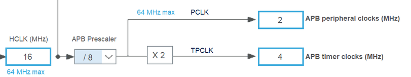

Datasheet RM0454 Rev 5:
"Timer clock
The timer clock TIMPCLK is derived from PCLK (used for APB) as follows:
1. If the APB prescaler is set to 1, TIMPCLK frequency is equal to PCLK frequency.
2. Otherwise, the TIMPCLK frequency is set to twice the PCLK frequency."
"The peripherals are clocked with the clocks from the bus they are attached to (HCLK for
AHB, PCLK for APB) except:
• TIMx, with these clock sources to select from:
– TIMPCLK (selectable for all timers) running at PCLK frequency if the APB
prescaler division factor is set to 1, or at twice the PCLK frequency otherwise"

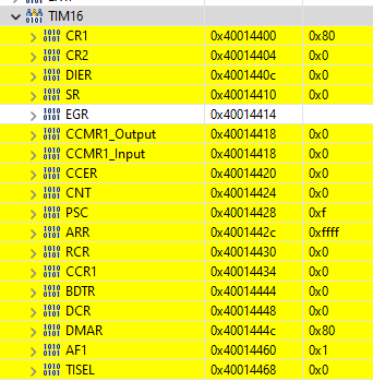

void TIM16_us_Tick(void)
	// Uses PCLK Clock = 16 MHz as source
	// -> According to the data sheet and with the AHB prescaler of 2, this should actually be 8 MHz.
	// However, the input frequency of the timer seems to be independent of the AHB prescaler.
	// Enable TIM16 Clock
	RCC->APBENR2 |= (0x1UL << 17);
	// Set CR1 register
	TIM16->CR1 &= ~TIM_CR1_UIFREMAP;
	TIM16->CR1 |= TIM_CR1_ARPE;
	// Set PSC register
	TIM16->PSC = 15; // Set prescaler to 15 -> 1us task for timer (f_timer = f_pclk / (1+prescaler))
	// Set ARR register
	TIM16->ARR = 0xFFFF;   // Maximum value (optional, depending on application)
	// Activate Timer
	//TIM16->CR1 |= TIM_CR1_CEN;
void delay_ms(uint16_t ms) {
    // Timer-Setup: Prescaler and ARR are already configured,
    // that the timer counts with 1 µs resolution.
	TIM16->CR1 |= TIM_CR1_CEN;   // start Timer
    for (uint16_t i = 0; i < ms; i++) {
        TIM16->CNT = 0;              // Reset counter to 0
        TIM16->SR &= ~TIM_SR_UIF;    // Reset update flag (UIF)
        //while (TIM16->CNT != 0);	 // Wait until the counter has been set to 0
        //TIM16->CR1 |= TIM_CR1_CEN;   // start Timer
        while (TIM16->CNT < 1000);   // wait 1000 µs = 1 ms
        //TIM16->CR1 &= ~TIM_CR1_CEN;  // stop Timer

 * System Clock = 16 MHz
 * AHB Clock = 4 MHz
 * APB Clock = 4 MHz
void SystemClock_Config(void)
	// 1. Select internal clock (HSI) with a frequency of 16 MHz
	// Clock control register (RCC_CR)
	RCC->CR |= RCC_CR_HSION; 					// turn HSI on
	while (!(RCC->CR & RCC_CR_HSIRDY));  		// Wait until HSI is stable
	RCC->CR &= ~RCC_CR_HSIDIV_Msk; 				// HSIDIV = 1
	RCC->CR &= ~RCC_CR_PLLON; 					// PLL Clock disable
	// Select HSISYS as System Clock
	// Set APB and AHB prescaler and disable clock output
	// Clock configuration register (RCC_CFGR)
	RCC->CFGR &= RCC_CFGR_SWS_HSISYS; 			// Select HSISYS as System Clock and disable clock output
	RCC->CFGR &= ~RCC_CFGR_PPRE_Msk; 			// Reset APB prescaler = 1
	RCC->CFGR &= ~RCC_CFGR_HPRE_Msk;			// Reset AHB prescaler = 1
	RCC->CFGR |= 0b1001 << RCC_CFGR_HPRE_Pos;	// Set AHB prescaler = 4
	// MCO clock settings:
	// Output: SYSCLK
	// Prescaler: 128 to improve measurement (1000 not possible)
	RCC->CFGR &= ~RCC_CFGR_MCOSEL_Msk; // Reset MCOSEL (clock selector)
	RCC->CFGR |= RCC_CFGR_MCOSEL_0; // choose SYSCLK
	RCC->CFGR &= ~RCC_CFGR_MCOPRE_Msk; // Reset MCOPRE (Prescaler)
	RCC->CFGR |= (0x7UL << RCC_CFGR_MCOPRE_Pos); // Set Prescaler to 128

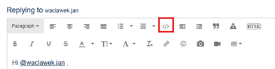

Hi @waclawek.jan ,
i editet the written text manually over the toolbar, for my code i used the "insert code" function:
Hope this answers your question? :)
First thank you for you advise, i willl do this in the future.
Here a sreenshot of the RCC CFGR register:
MCOPRE = 0x7 -> sets prescaler for the MCO output to 128 -> correct
MCOSEL = 0x1 -> Set SYSCLK for MCO output -> correct
MCO2PRE and MCO2SEL these two parameters are not adjusted
PPRE = 0x0 -> APB prescale = 1 -> correct
HPRE = 0x9 -> AHB prescaler = 4 -> correct
SWS = 0x0 -> SYSCLK = HSISYS (read only - therefore correct)
SW = 0x0 -> SYSCLK = HSISYS -> correct
So the RCC CFGR register seems to be correct in my point of view - Nevertheless, I will follow your advice on writing the registers in the future :)
Here is the screenshot for timer 16 - at the time before the delay function is called.
Does this help? :)
