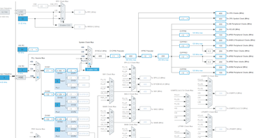

Only works when im doing firmware update to 5MHZ HSE.
I tried to configure a setting trough stm32cubeMX with 8MHZ as input and 400MHZ as Sysclk  but got only garbge when printing.
I add this code + the stm32h..msp file to my src to the lwip_netconn_rtos example
Any ideas or explaination would be awosome thx!

When configure:
STLINK V3 CLOCK = 5MHZ HSE with the following settings:

The printf works - even though its configured to 8MHZ in code but 5MHZ in STLINK.
But when trying to use 5MHZ HSE of STLINK after firmware update
And code that generated by STM32cubeMX with 5MHZ as input frequenccy and 400MHZ as clock.
The printf doesnt work and outputs garbage.
Any ideas?

So l got 2 questions:
1. How did it even worked when I used 5MHZ as input in the ST-LINKV3 firrmware update?

2. If i want to use the 5MHZ update in the ST-LINKV3 I need to change the
__STM32H7xx_HAL_CONF_H to this:
/* ########################## Oscillator Values adaptation ####################*/
  * @brief Adjust the value of External High Speed oscillator (HSE) used in your application.
  *        This value is used by the RCC HAL module to compute the system frequency
  *        (when HSE is used as system clock source, directly or through the PLL).
#if !defined  (HSE_VALUE)
#define HSE_VALUE    ((uint32_t)5000000) /*!< Value of the External oscillator in Hz */
#endif /* HSE_VALUE */​
and set the following settings in clock tree: ?
Thanks alot for your help and I hope this post will help more ppls (:
Pavel A.
The problem is that the bypass HSE clock source going from the ST-LINK has two options: the default is 8.0 MHz but its source is HSI - which is imprecise. If you want the precise HSE - then the frequency will be 25/3 = 8.3(3).
With the latest firmware you can select  also HSE/5.
You can also use 5MHZ HSE -
https://community.st.com/t5/stm32-mcus/how-to-use-stlink-v3-mco-output-on-nucleo-boards-as-a-precise/ta-p/723361
I Hope it will help you also (:
with this can you look at my 2 questions above please?
@Pavel A.
Thanks (:
Is HSE_VALUE defined in the Eclipse project preprocessor defines? Defining only in hal_conf.h is not enough IIRC. I don't remember why exactly.
Yep I stand corrected, thanks.
