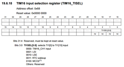

I have a small problem understanding the timer 16 of the STM32G030K6T6 microcontroller. According to the data sheet, it should use the TIMPCLK clock, which corresponds to the PCLK clock.
My system clock is supplied by the HSI (SYSCLK = 16 MHz). I have set my AHB prescaler to 4 and the APB prescaler to 1, so HCLK = PCLK = 4 MHz. Since my APB prescaler is equal to 1, the timer clock should be TIMPCLK = PCLK = 4 MHz.
I then implemented a delay function with timer 16. So that the counter runs up in 1 us steps, I have to set the prescaler of the timer to 15 instead of 3. This means that the timer 16 still has a 16 MHz signal as an input signal.
Now my question is: Have I misunderstood something here, is the data sheet wrong or is my code not correct? I have attached the quotes from the data sheet and my code. I hope you can help me.
Datasheet RM0454 Rev 5:
"Timer clock
The timer clock TIMPCLK is derived from PCLK (used for APB) as follows:
1. If the APB prescaler is set to 1, TIMPCLK frequency is equal to PCLK frequency.
2. Otherwise, the TIMPCLK frequency is set to twice the PCLK frequency."
"The peripherals are clocked with the clocks from the bus they are attached to (HCLK for
AHB, PCLK for APB) except:
• TIMx, with these clock sources to select from:
– TIMPCLK (selectable for all timers) running at PCLK frequency if the APB
prescaler division factor is set to 1, or at twice the PCLK frequency otherwise"

Hi @MM..1 ,
thank you in general for wanting to help :)
The inputs for the timer 16 are a little bit different:
TI1SEL is set to 0x0 here, correspondingly TIM16_CH1 is selected here. My understanding is that in this case TIMPCLK is used as the input for the counter (?) .
waclawek.jan
OK I think I know what's the problem.
TIMx_PSC is unconditionally preloaded. It means, the value written to it is not used in the internal prescaler, until there is an Update event. Update is basically an overflow; but as you use the timer so that you always stop it before it reaches the overflow, your TIMx_PSC is never applied.
You can test this assertion by using various values for TIMx_PSC, the result should be the same.
I also believe that you compile with all optimizations off, which results in the loopdelay taking longer than just the pure 1000 timer clocks, masking the real timing of the timer.
TI1SEL dont setup timer clk.
@MM..1
Which register is used to select the input of the counter? :)
