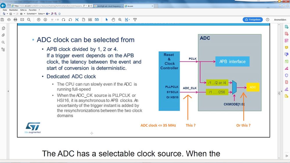

STM32G0 ADC clock.
Max. asynchronous clock according to datasheet is 35 MHz.
Is this (35 MHz) the input to PRESC or the output of PRESC ?

Yes, 32 MHz is okay, 64 not.
( The effective clock going to the ADC, after the prescaler. )
And set a sampling time, that's big enough to match the source impedance, see ds about that.

The ACD clock limitation is behind the divider (in your picture marked as "Or this ?")
‎2024-08-17 9:37 AM
My question is in CubeMx Configuration the PCLK is 64MHz in my case STM32G070RB series and similarly to ADC clk configure at 64MHz.
if i configure ADC setting clock prescalar as synchronous clock mode divide by 2 means -> ADC operate at 32MHz. It is within the range of ADC characteristics mention in datasheet (f_ADC =35MHz (max)) to get optimum performance of ADC.
If i choose ADC clock prescalar as asynchronous clock mode divide by 1 means -> ADC operate at 64MHz. This configuration may cause any adc performance problem?
