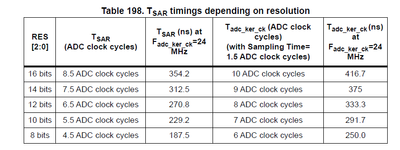

The ADC needs some clocks to convert, 15 or so, plus sampling time ; and depending on source impedance you need longer sampling time, so set not the shortest possible, try 7.5 ; then you get about 1us sampling.
(48MHz /2 -> 24 / 20 clocks -> about 1 us ).

Just look at ds, how many clocks your ADC at the resolution you set needs, then add the sampling clocks to get total ADC conversion time. You cannot choose everything as you like, only certain steps are possible to set - obviously.
But you can choose the basic clock for ADC and the division of the clock, so by choosing a certain clock for the ADC and a sample time, you can adjust it.

When we now caculate the sample time:
TCONV = Sampling time + 8.5 ADC clock cycles
TCONV = 32.5 + 8.5 = 41 cycles or 48 / 41 = 1.170 M samples.

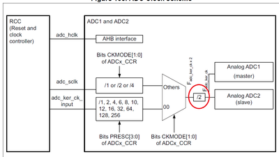

Hmmm... look in RM, ADC block picture, some ADC have internal /2 division, so running on half clock rate. Maybe depends on version of chip, V or Y or so. Check this.
And just try with shorter sampling time, to get about 24 cycles, and see, what happens.
When we reduce the sample time to 25 cycles we have the same issue. Sample rate is 2 times lower than the calculated sample rate.
So there is somthing internal that pre divide the ADC clock by 2.
==>  Maybe depends on version of chip, V or Y
Where i can find this information?

We cannot find the the single letter, V or Y or Z... on the chip.
But we found this in the datasheet. So the Clock of the ADC is always divided by 2.
