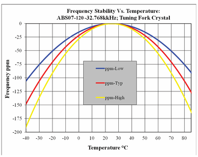

I created one prototype using an Abracon 32.768kHz crystal for the LSE, with two C0G 6pF load capacitors. To test the prototype, I routed the LSE to the MCO1 and measured the clock frequency as we swept the temperature from -20°C to 70°C in our temperature chamber. I measured that and compared the ppm deviation to the expected deviation given by abracon (ppm = (T-25°C)^2 * (-0.035ppm)):

  • The temperature slope I measured was different from the one given by the Abracon datasheet

From the crystal datasheet, the range in accuracy varies by more than 20ppm over the 20-70 temperature range. Note the delta from the blue and yellow lines.
So that's not a viable solution unless you have the tools and time to calibrate each crystal independently.
You're better off with a TCXO.
