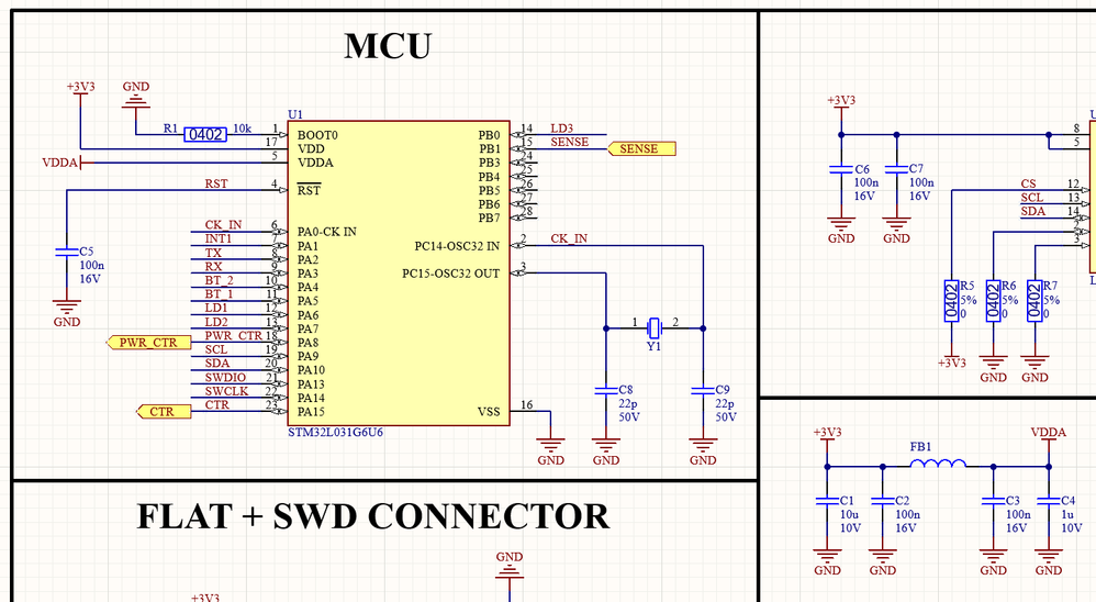

I have a problem with a STM32L031G in a custom board.
The program don't run after the program.
BOOT0 is connected to gnd via 10K resistor.
Attached you can find a circuit diagram and clock configuration.
what could be the problem?
Thanks
Michele

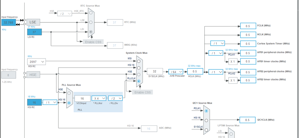

void SystemClock_Config(void)
  RCC_PeriphCLKInitTypeDef PeriphClkInit = {0};
  __HAL_PWR_VOLTAGESCALING_CONFIG(PWR_REGULATOR_VOLTAGE_SCALE1);
  RCC_OscInitStruct.OscillatorType = RCC_OSCILLATORTYPE_HSI;
  RCC_OscInitStruct.PLL.PLLSource = RCC_PLLSOURCE_HSI;
  RCC_OscInitStruct.PLL.PLLMUL = RCC_PLLMUL_4;
  RCC_OscInitStruct.PLL.PLLDIV = RCC_PLLDIV_2;
    Error_Handler();
  RCC_ClkInitStruct.AHBCLKDivider = RCC_SYSCLK_DIV64;
  RCC_ClkInitStruct.APB1CLKDivider = RCC_HCLK_DIV1;
  RCC_ClkInitStruct.APB2CLKDivider = RCC_HCLK_DIV1;
  if (HAL_RCC_ClockConfig(&RCC_ClkInitStruct, FLASH_LATENCY_0) != HAL_OK)
    Error_Handler();
  PeriphClkInit.PeriphClockSelection = RCC_PERIPHCLK_I2C1;
  PeriphClkInit.I2c1ClockSelection = RCC_I2C1CLKSOURCE_PCLK1;
  if (HAL_RCCEx_PeriphCLKConfig(&PeriphClkInit) != HAL_OK)
    Error_Handler();
SchematicSchematicClock ConfigurationClock Configuration

Skip SystemClock_Config() entirely, let the system continue to run at the clock it started on, and not the snail paced 500 KHz. Watch the 1KHz SysTick doesn't saturate.

BOOT0 is Low, so perhaps double check the validity of the Initial SP and PC in the Vector Table. Check Option Bytes if using those.

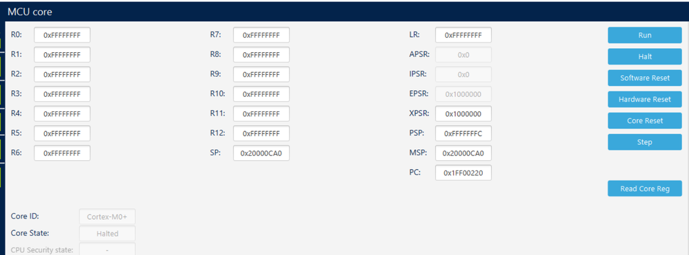

Use the debugger, stop the MCU, confirm where it's stuck. In your own code, or in the ROM.
I removed all the code from the main and left a test blink, but still the code does not run. In the function ‘Error_Handler(void)’ I entered a command, but it is never executed...
I skipped the ‘SystemClock_Config()’ function but it still does not work.

Update:
if upload the code and press "software reset" and "run" in STM32CubeProgrammer the uC execute the code without problem.
