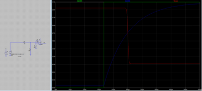

The Input is LOW to HIGH impulse (Green color on the simulation graph).
The output is HIGH to LOW impulse that is slightly delayed from Input (Red color on the simulation graph).
See the simulation graph below:

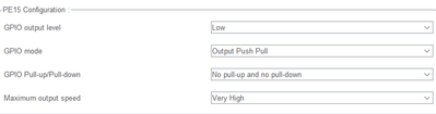

1. Configure one pin (PE15) as GPIO_OUTPUT and use this pin to generate input impulse. The pin is configured as shown below:

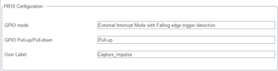

2. Configure another pin (PB10) as GPIO_EXTI and connect this pin to output signal that needs to be detected. This is configured to capture falling edge as shown below:

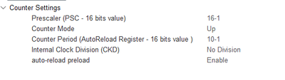

3. Use one of the general purpose timers that is configured for 1MHz to count the number of timer ticks between the GPIO Input impulse is generated and GPIO_EXTI callback is fired (falling edge of the output is detected). I have chosen TIM10 for testing purposes:
Since my APB2 timer clock frequency is 160 MHz, by selecting Prescaler as 16 and Counter period 10 I should get 1MHz timer.

When the falling edge of the output is detected, the following callback will be triggered:
void HAL_GPIO_EXTI_Callback(uint16_t GPIO_Pin)
    if(GPIO_Pin == GPIO_PIN_10) // If The INT Source Is EXTI Line9 (A9 Pin)
		HAL_TIM_Base_Stop_IT(&htim10); // timer for impulse counter
		printf("impulse counter = %u \n",impulse_counter);
		impulse_counter = 0;
which is going to stop the TIM10 and print out how many impulses have been detected.

I am not satisfied with the results. According to the simulation and the measurements I have captured using RIGOL DS1054 oscilloscope, the result should be 120us. As you can see from my results, the timer only counted 97 ticks (97 us) which is a little bit off.
I have tried to reconfigure the TIM10 prescaler to 160 instead (Timer should now run at 100KHz). And the results are as following:
Initialization complete
impulse counter = 12
which makes sense since my timer is fired every 10us period and it detected 12 pulses so that means the time elapsed is around 120us. However I cannot fully understand why it does not work properly when the TIM10 is configured to run at 1MHz. Is that pushing over the limits of TIM10 capabilities?
My questions:
1. Why it does not seem to work properly when TIM10 is configured at 1MHZ
2. Is there a better method than the one I chose to capture the time with good accuracy?
1MHz interrupt rate is not very realistic, especially when using Cube/HAL.
