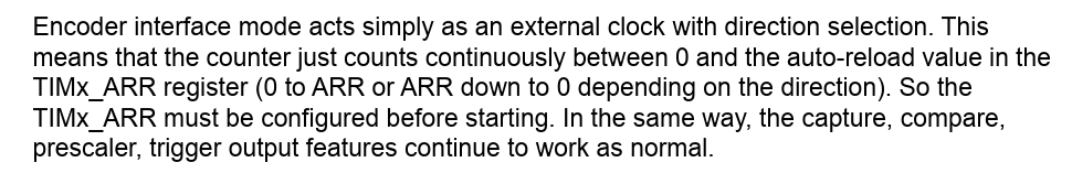

the counter have no negative values :
see rm:
So you read out timer with something wrong : maybe you read it as int ?
(signed...so compiler will show 0xFFFF as -1 . )
Read it, as it is : uint16_t , or uint32_t . Then check, what it gives you back.
btw
You could do it intentionally also, to get negative values : if you set the ARR to max. value (0xFFFF for 16 bit counter), and read it as int16_t , then compiler will use it as signed and you get: 0,1,2,3...or 0,-1,-2,...:
but be aware of roll over : turn negative will go from 0 to 0xFFFF , 0 -> -1 , but at 0x8000 next is 0x07FFF,
so - 32768 -> + 32767 . :)
