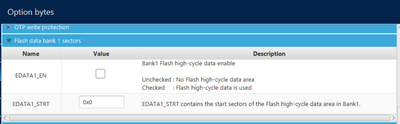

On flash option byte I need to use only one sector. Only Edata bank1 is activate. No other option bytes are required.
CubeMx generate MX_FLASH_Init with Edata configuration commented. What other option byte is necessary to select to use Edata on bank1?

Did you try to check the EDATA1_EN option byte using STM3CubeProgrammer?

I have the similar question. My board is STM32H573I-DK. EData seems not be enabled after MX_FLASH_Init().
Here is the code generated by CubeMX.

I tried to access 0x0900A800 by CubeProgrammer but it showed Data read failed.
But if checked the EDATA1_EN option by CubeProgrammer. It worked.
Is there any bug or what I missed?
P.S. I also uncommented
/*HAL_FLASH_OB_Launch(); */
but still not worked.
I don't know if you resolved your issue but for anyone struggling with this, the problem is that HAL_FLASH_OB_Launch() won't work after HAL_FLASH_OB_Lock(). I resolved it by adding the following function:
void USER_FLASH_LaunchOB(void)
  if (HAL_FLASH_Unlock() != HAL_OK)
    Error_Handler();
  if (HAL_FLASH_OB_Unlock() != HAL_OK)
    Error_Handler();
  if (HAL_FLASH_OB_Launch() != HAL_OK)
    Error_Handler();
  if (HAL_FLASH_OB_Lock() != HAL_OK)
    Error_Handler();
  if (HAL_FLASH_Lock() != HAL_OK)
    Error_Handler();
and running it after MX_FLASH_Init()
