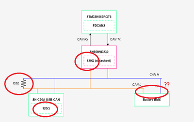

Board & Setup:
  • STM32H563RGT6 running FDCAN2 in Normal mode (HAL_FDCAN_Init, Mode=FDCAN_MODE_NORMAL)
  • SN65HVD230 transceiver in silent mode (Rs pin connected to 3.3V) (120 Ω intergrated) wired with a single 120 Ω terminator at the far end
  • No other pull-up/down or termination changes when the USB–CAN dongle is unplugged
  • Filters configured (Reading the data from the BMS of a custom battery):
    • FIFO0 → IDs 0x1E0 (BMS_STATE), 0x1E2 (PACK_MINMAX), 0x1E3 (PACK_AVG)
    • FIFO1 → ID 0x1E1 (PACK_VALUES)

The battery (or BMS) I was talking about is a node which is connected to the CAN bus. The "master" is the SN65HVD230 transceiver which is connected to the CAN Tx and Rx of the STM32H563RGT6 (pins PB5 and PB13 to be exact -> FDCAN2).
So, RS pin is connected to 3.3V directly or has a pull-up resistor to 3.3V?
Does the USB–CAN adapter have a terminating resistor enabled?
If so, it sounds like the STM32 terminating resistor may be an open circuit? So when you remove the USB–CAN adapter, there is only 1 terminating resistor on the far end. The USB–CAN adapter is probably the node that is sending the ACK, not the STM32.
Draw a block diagram showing your nodes, CAN bus wires, and where the terminating resistors are.

I have a switch that connects the Rs pin directly to 3.3V or to a 10k resistor to ground. Right now the only way it works is directly connected to 3.3V.
The USB-CAN terminating resistor is enabled, but I tried to disable it and it didn't seem to be the problem. This totally makes sense, it's the conclusion I'm leaning towards -> The USB–CAN adapter is probably the node that is sending the ACK, not the STM32.
There is no integrated 120 ohm resistor on the SN65HVD230 neither to any CAN transceiver in the market.
But is is available in your hardware outside  here:
Try to shunt the R1 resistor so Rs pin will be connected directly to the ground:
Shunting the R1 resistor didn't seem to affect the problem.
Not clear how many 120 ohm terminating resistors in your CAN bus:
What I suggest is to power off all the nodes and measure the resistance between CAN_H and CAN_L.
You need to have ~60ohm resistor value equivalent to 2x120 ohm resistors in parallel.
