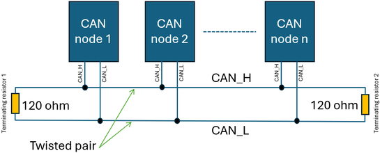

I checked and all nodes had 120 ohms resistors. So I removed the one at the end of the CAN bus and the one from the USB-CAN. This leaves the one from the BMS and the CAN transceiver.
I attached the configuration of my FDCAN2 which is the one I use for the CAN communication. I am forced to use a bitrate of 250kbits/s since the BMS is forcing that speed. I should note that the CAN is classic and only standard IDs (11 bits) will be used.
You need only two terminating resistors at both sides of the bus:

  • STM32H563RGT6 running FDCAN2 in Normal mode (HAL_FDCAN_Init, Mode=FDCAN_MODE_NORMAL)
  • SN65HVD230 transceiver in silent mode (Rs pin connected to 3.3V) (120 Ω intergrated) wired with a single 120 Ω terminator at the far end
I missed this earlier but the CAN transceiver can not be in low power mode. You need to keep the RS pin grounded in order for the STM32 CAN Controller to ACK.
