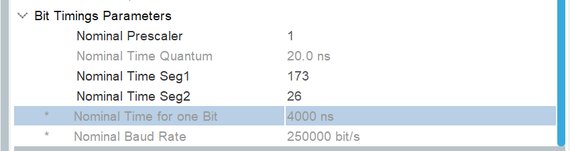

Your seg2 is almost the same as seg1. So your sampling point is almost in the middle. You want to sample close to 87% give or take
If the FDCAN clock is 50MHz, then try these values

I changed to the typedef union which is practical, but does not eliminate the problem of the communication. Also I changed to HSE clock which is 12 MHz in my case so I now have different parameters for the same bitrate (250 kbits/s), but it does not seem to be the solution.
Please attach your ioc file.
I'm using my 12 MHz HSE with these parameters.
Here's my .ioc file as of now.
If you are using HSE for the FDCAN, do you actually have an external oscillator? If so, what frequency?

Assuming you have an external clock at 12MHz, try the attached IOC changed to use 66MHz and use the values below. I have values for 12MHz as well
 Baud 250000 bit/s
FDCAN clock freq(kHz)seg1seg2 prescaler
120003981
66000219441
