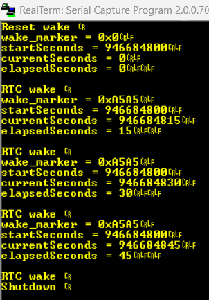

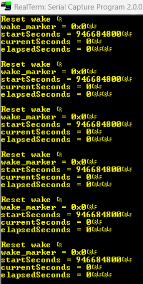

I modified the code in main (including the version in this post) to send the data over UART for debugging.
I send the values of startSeconds, currentSeconds, elapsedSeconds and whether the wakeup source was RTC, WKUP pin or reset.
I can see after a cold reset that the RTC backup is always zero, so it always thinks its waking up from reset.
Why does the RTC back work in debug/run mode, but not in standalone after a cold reset ?
In debug/run mode the terminal result is:
After cold reset the terminal result is:

After a week of trying to debug this and pulling my hair out, I have finally found the problem
To help others who are having problems, this is what I found and the fix.
The problem was with the following code (in main)…
if (__HAL_PWR_GET_FLAG(PWR_FLAG_SB)) {
		// woken from low power mode
		__HAL_PWR_CLEAR_FLAG(PWR_FLAG_SB);
PWR_FLAG_SB does not work in standalone after power reset, it only works in debug / run.
As wake markers are already implemented, I removed the PWR_FLAG_SB check and used the wake markers to detect whether the wake was from reset, RTC or WKUP pin
It appears STM32 low-power modes (especially Shutdown) behave differently between debug and standalone.
The fixed code is below...
	wake_marker = HAL_RTCEx_BKUPRead(&hrtc, RTC_BKP_DR2);
	if (wake_marker == WAKE_FROM_SLEEP_RTC)
		// woken from sleep (RTC wake)
		wakeConfigUpdate(); // get time and date and restore reference pressure from RTC backup register
		uint32_t tmp = HAL_RTCEx_BKUPRead(&hrtc, RTC_BKP_DR3); // restore power switch state from RTC backup register
		powerSeq = *(uint8_t*)&tmp;
		// check if elapsed time is greater then shutdown time
		if (elapsedSeconds >= RTC_SHUTDOWN_S)
			mcuPowerdown();
	else if (wake_marker == WAKE_FROM_SHUTDOWN_WKUP)
		// woken from shutdown (power switch pressed during shutdown)
		wakeConfigReset(); // reset time and date and set default reference pressure
	else
		// woken from reset
		// store value in RTC backup register to indicate mcu was reset
		HAL_RTCEx_BKUPWrite(&hrtc, RTC_BKP_DR2, WAKE_FROM_RESET);
ChatGPT explained the reasoning behind the behaviou....
In debug or run mode (e.g. via ST-Link or when powered via USB), the power is never fully removed — so:
Certain power control and backup domain registers (like PWR->CSR and RTC backup regs) may retain their values.
The SB flag can remain set, giving the impression it survived SHUTDOWN.
Why it fails in standalone after a cold reset:
In SHUTDOWN mode, only the RTC and backup domain are retained via VBAT.
However, on most STM32s:
The SB flag does not survive SHUTDOWN (it's not designed to — unlike in STANDBY mode).
After a cold power cycle, everything except what’s powered by VBAT is reset — including that flag.
Hence, __HAL_PWR_GET_FLAG(PWR_FLAG_SB) returns false.
TL;DR
PWR_FLAG_SB is only valid for detecting wake from STANDBY, not SHUTDOWN.
It might "appear" to work in debug due to partial power retention or debugger interference — but it's not reliable.
Always use backup register markers or the RTC time to infer wake source across SHUTDOWN.
