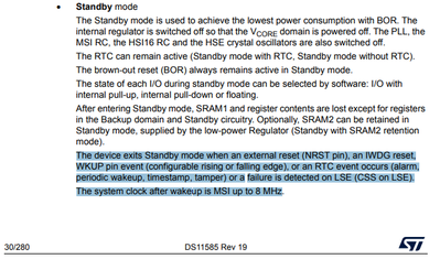

Hello @saikumar31 and welcome to the ST Community.
As you can see on the DS11585 Rev 19 page 30:
"The device exits Standby mode when an external reset (NRST pin), an IWDG reset,
WKUP pin event (configurable rising or falling edge), or an RTC event occurs (alarm,
periodic wakeup, timestamp, tamper) or a failure is detected on LSE (CSS on LSE)."

‎2024-11-11 4:10 AM
Yes, i understood that give confirmation that upon configuring pin PC13 as an external interrupt instead of SYS_WK still is that possible to wakeup the device on an external interrupt event ?

‎2024-11-11 4:30 AM
Yes, the same thing i interfaced the ST's IIS3DWB MEMS sensor ,currently i'm getting interrups on INT2 pin of the IIS3DWB when there a motion or vibration is detected, the INT2 pin of MEMS sensor is connected to the PC13 , and the PC13 is configured as a EXTI, now if i get interrupt on the INT2 pin does the PC13 recognizes and wakes up the MCU from Standby mode?
‎2024-11-11 5:50 AM - edited ‎2024-11-11 6:38 AM
As mentioned on the paragraph I shared with you. The PC13 should be configured as a Wake-up pin to wake up the MCU from standby mode. EXTI is not a source of Wake-up.
