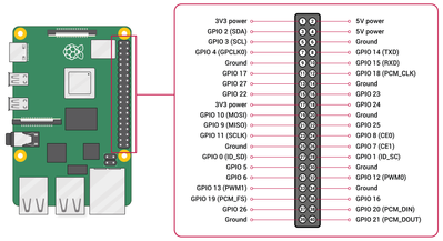

This one:
Check out the Raspberry Pi documentation to see what signals are available on that connector:
https://www.raspberrypi.com/documentation/computers/raspberry-pi.html#gpio-and-the-40-pin-header
You can clearly see that UART (TXD, RXD), SPI (MOSI, MISO, SCLK), and I2C (SDA, SCL) are all available on that connector, and documented on that page:
https://www.raspberrypi.com/documentation/computers/raspberry-pi.html#alternative-functions

@Andrew Neil wrote:
your posts are not very clear at all!
@suhfi  One thing that would help would be to provide diagrams/pictures - so that we can actually see what you're taking about, rather than just rely on text.
Especially as there seems to be a bit of a language barrier.
okay, thank you for the advice. i am gonna follow that. no i am not talking about the connector over there. i am talking about the usb connector. as in my previous discussion i came to know that usart via usb is possible between raspberry pi and stm32 nucleo board. i am wondering if usb connector supports i2c or spi just like uart?
