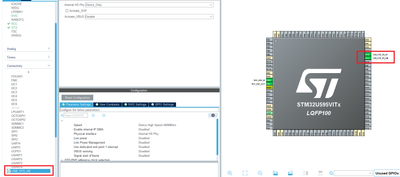

I can set PA11 and PA12 for USB in CubeMx for STM32U595.

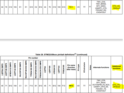

Infact, PA11 and PA12 provide OTG_HS additional functions, and they are not alternate functions:
When you enable the USB_OTG_HS (as done by my college @SofLit ) those Pins are automatically set to OTG_HS additional functions.

Yes, actually I found that OTG_HS_DP is additional function. But I don't know how to configure it. In cubemx generated framework is that done by MX_USB_OTG_HS_PCD_Init()?

You can use CubeMx and configure USB pins as I showed above.

Hello @Yang Yang
It is not required to add the code to configure the USB DP/DM as those pins are directly connected to USB as soon as this peripheral is enabled.

The pins config is not generated. These pins are used directly by the USB as soon as the USB is enabled.

 PA12 is internally set to OTG_HS_DP as soon as you Enable your USB_OTG as i said on my second comment (no code needed to do that).
