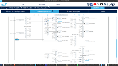

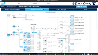

I have set up the clock for the stm to 192MHZ due to the other components that will be added later, and the pll2 is set to 24MHZ for the usb as shown below.

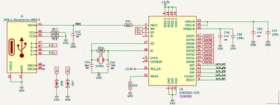

lastly the specific usb3300 im using it's datasheet can be found in the attached file and the setup for the usb (how I was given the usb) is shown below in the picture.

Hi  @Igneous I looked at your schematic design and compared it with what I have, they look almost the same. The difference is that I am using STM32H723ZGT6.

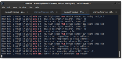

I found the issue being device descriptor.
I have repeated the configuration process several times (just like yours with the only difference being the chip and clock 25MHz) in STM32CUBEMX, I still find the same problem.
I wonder is some might be able to help me here. So I will attach the .ioc file here. Thanks.
