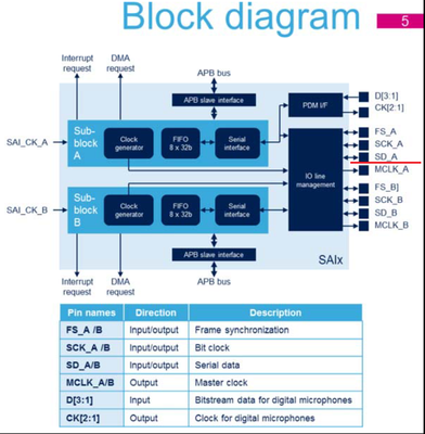

Sorry, I don't work on MCU products, but I can try to answer for HW point of view.
FS is synchro (usually audio sample rate)
SCK is clock for serial data sent on SDA and receive on SDB (if there is audio input path). usually 256xFS
info in STM32L5-Peripheral_Serial_Audio_Interface_SAI.pdf
Regards

Thank you, we are approaching the subject (after your .pdf) this information is interesting :
After your explanation you say : 'SCK is clock for serial data sent on SDA and receive on SDB (if there is audio input path)'
But I have nothing to send, I just need to retrieve the values ​​sent by the CODEC via the SAI only, in this case I just use the SDB right ,

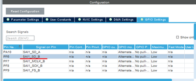

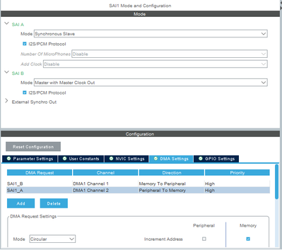

Currently I have this configuration :
And it works, I can simulate data sent by the CODEC with an array initialized by myself and I receive the values ​​in the RX array. Now I move on to another step which consists of recovering the real data sent by the CODEC. In this case I don't needto use SD_B right ?
Probably, I keep this configuration but in my code I will only use SD_A (which I use to retrieve the data).
