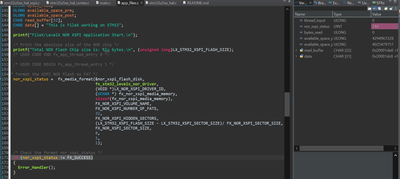

I’m trying to use the external NOR flash (MX66UW1G45G) on the STM32U5G9J-DK2 board as the storage backend for a FAT filesystem using FileX.
I came across the example “Fx_NoR_Write_Read_File” from STM32CubeIDE (STM32U5G9J-DK2 package), which appears to be doing exactly this — creating a FAT filesystem using FileX and LevelX on the external NOR via XSPI. However, it’s .ioc file is missing, so I can’t see how the XSPI interface and pins are configured.
I built and flashed the example as-is, but the fx_media_format() call returns FX_IO_ERROR (0x90 in Hex and 144 in decimal).

Hello @Dor_RH
Thank you for the clarification on the .ioc file.
However, the issue with fx_media_format() returning FX_IO_ERROR still persist - any guidance on this would be appreciated.

The Sector (Erase) Size on the MX66UW1G45G is 4KB, this should be the sector size you use on most QSPI/XSPI NOR Flash devices for a FAT file system, otherwise deblocking will be an absolute nightmare.
The Page Size (Write) is 256 bytes, so will take 16 separate (aligned) operations to write a 4KB sector that's previously been erased.
To understand where upper level errors come from it might be instructive to output diagnostic / telemetry data from the lower / block level interactions, ie for FATFS implementation how DISKIO interacts with the BSP/CSP code. Likely equivalents for FILEX
