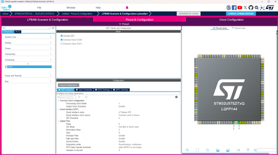

‎2025-06-19 2:25 AM - edited ‎2025-06-19 2:25 AM
Hello again @coppercrimp,
After double checking, the ADF issue has been fixed since CubeMX version 6.12.0.
I've tested it on version 6.14 and it works on my end:
Could you confirm this on your end?

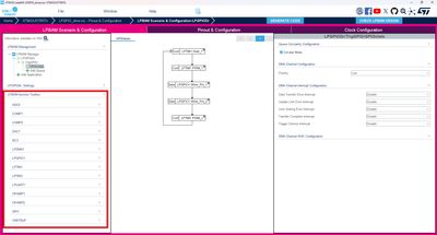

‎2025-06-19 10:45 AM
Hi Sarra,
I'm also using version 6.14 and can see the settings screen you shared. However, I was specifically referring to the "LPBAM Scenario & Configuration" tab and the "LPBAM function toolbox" (see screenshot). Every LPBAM example I've seen instructs you to build a scenario queue by selecting peripherals in the LPBAM function toolbox. But the ADF and MDF peripherals are missing from this toolbox
