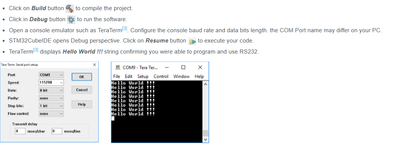

I Tried to flash the uart code in stm32 N657 Nucleo Board, but it is not responding, i was able to make the Leds, blink in the N6 board. Please help me out, i am using the uart example printf code in the N6 stm32 package. I tried the normal method used in the STM32 F4 MCUs, also the selection of peripherals are different in the IOC file. also please explain how to configure the RCC and other peripherals in the IOC file of these N6 boards

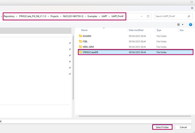

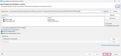

Hello @VicxSri;
1- Download the STM32CubeN6 firmware from ST.web site.

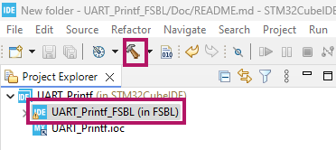

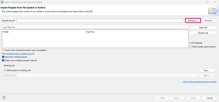

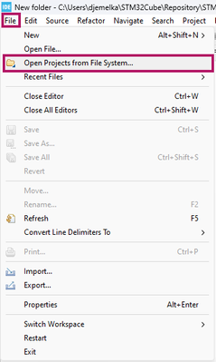

2- Open the UART_Printf using STM32CubeIDE as shown in the below figures:
KDJEM1_0-1750321939912.png5-
3- Build the project: make sure that the the build finished without error
4- Connect the board and click on debug
5- Open tera term and change the settings
6-  click on resume to execute code and to see the message in tera term
I hope this help you.
Thank you.
Kaouthar

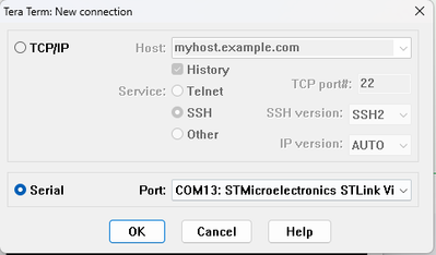

I didn't receive errors messages, what i was trying to say is that i didn't receive any output in the tera term.
KDJEM.1
Hello @VicxSri;
Thank you for this clarification.

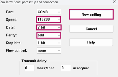

Please make sure that:

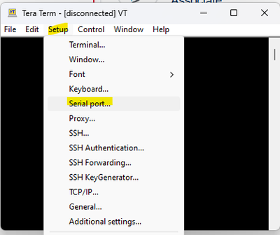

- You choose the adequate serial port as shown in the below figure:
- The HyperTerminal is configured with the correct value
For UART_Printf Example the HyperTerminal configuration (as mentioned in the readme) is:
  • Data Length = 7 Bits
  • One Stop Bit
  • Odd parity
  • BaudRate = 115200 baud
  • Flow control: None
