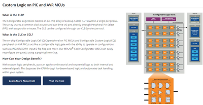

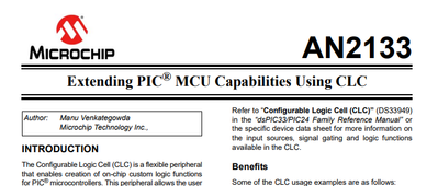

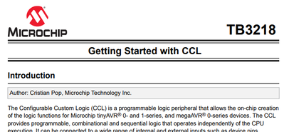

@Andrew Neil wrote:
@BarryWhit wrote:microchip has had this in their product lines for a long time (they call it "CLC").
* CCL (Configurable Custom Logic)
Oh, that's interesting. I thought you were clearly wrong but then I discovered we are both right.
This feature exists in Microchip's PIC line under the name "CLC" (Configurable Logic Cell).
It's also in ATMEL's AVR line as "CCL" (Configurable Custom Logic), which of course microchip swallowed.
I'm not sure if the moronic name difference is evidence this feature existed in the AVR line before the takeover,
or whether they deliberately chose different names, so they could refer to one implementation or the other unambiguously.
In any case the picture now is clear: why are STM32 chips missing this "Industry-Standard" feature? ;)

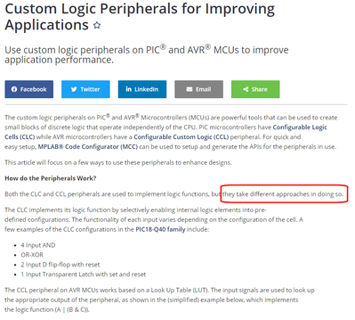

‎2024-06-28 4:55 AM
@Andrew Neil wrote:Still not clear from that whether CCL and CLC are identical.
It appears that they are different:
‎2024-06-28 5:00 AM - edited ‎2024-07-01 7:32 AM
@BarryWhit wrote:I'm not sure if the moronic name difference is evidence this feature existed in the AVR line before the takeover
I don't think it did ?
If true then that is evidence that Microchip liked what adding CLC to the PIC line did for sales, so much so that they decided the same business decision makes sense for the AVR line.
If not, that means Atmel's own market-research independently reached the same conclusion - that adding this feature would increase profits/market share.
Either way, looks like a strong signal for ST's bean-counters that the market wants this.

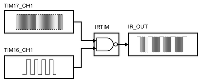

First of all, I am not suggesting to add something like an small FGPA but indeed, as many replicants noted, configurable logic like present in the Microchip ATSAMD51. STM32 MCU's are very good at things like motor control and communication but not soo for use with 'generic' control applications requiring all kinds of real time signals to react on and be generated in real time so by using peripherals and not software. The STM32 timers are great for this with IC/OC/PWM/Encoder and so on but not generic enough for the purposes I see. As such the suggested functionality is indeed just another peripheral. I think ST recognizes this too, look for instance at the new IRTIM peripheral in the STM32U5 range.
This is what I mean, be it that this is not generic in any way and targeting one very dedicated application, generating modulated IR signals using fixed timers.
Suppose now that the sources and the sinks for this gate and its functionality (AND, NAND, OR, NOR, ...) would be configurable........
It's there since the 'F0, some 10 years ago... :)

> Still it is an example of a very dedicated application of glue logic which when made generic would be more usable
I'm not sure in this very case.
The same effect can be achieved using features existing in STM32 ever since, namely by properly programming two timers using master-slave interconnection and gated mode in slave.
IMO this was added because of a client willing to pay a custom "module" in hardware rather than pay programmers who understand the intricacies of STM32 timers.
I keep repeating, this too boils down to inadequate documentation.
