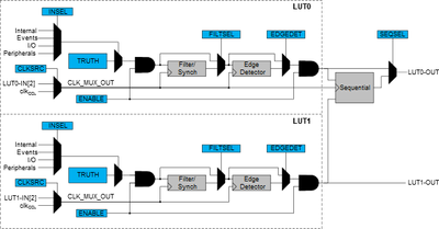

Competing products offer this kind of functionality more and more, for instance the Microchip SAMD51 offers a Custom Logic cell which is highly programmable.

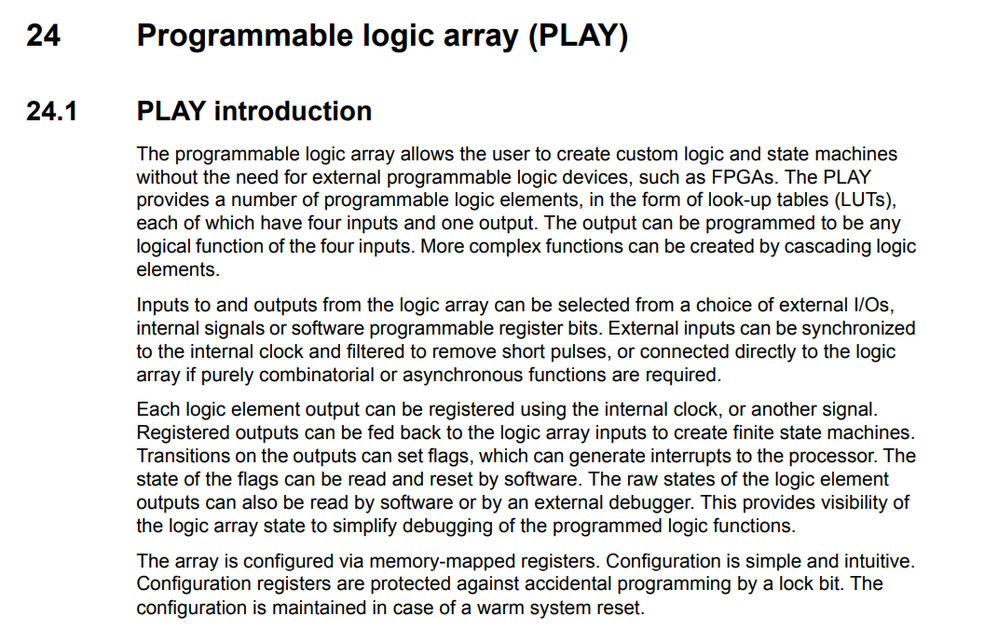

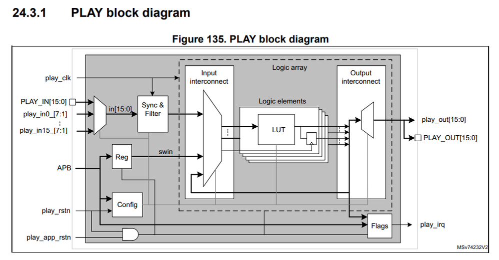

Best answer by mƎALLEm
Getting back to this old thread and to announce that PLAY (Programmable logic array) peripheral wasintroduced in the new STM32H5 series (H5F/H5E).
You can refer to the reference manual RM0517 / section 24 Programmable logic array (PLAY) for more details.
Enjoy the new feature :).

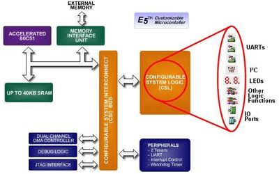

I remember the Triscend devices:
 https://antronics.co.uk/portfolio/csoc/
The tooling was, indeed, key.
And it did take a lot of support - someone had to help them: https://developer.arm.com/documentation/kan159/latest/

I found it really useful - being able to customise the peripheral set exactly to the application requirements.

Microchip have their CCL (Configurable Custom Logic) peripheral in some AVRs:
https://onlinedocs.microchip.com/pr/GUID-C866D457-41E2-43C7-8442-2F1193FAAD9F-en-US-4/index.html?GUID-BCB62DAC-D256-4F52-854F-36AFF54FDB3C

configurable logic like present in the Microchip ATSAMD51.
that's another one that was originally Atmel and, as for AVR, calls it CCL:
https://www.microchip.com/en-us/product/atsamd51g19a#:~:text=One%20Configurable%20Custom%20Logic%20(CCL)
which may or may not be of any significance at all ...
