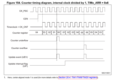

I am generating PWM signals for 4 channels using TIM1, with 2 complimentary outputs. The CCR values should come from an array lookup table via DMA.

I am not getting the 160 values as per the array value
FPWM is 16KHZ
What wrong with me ?

Center aligned mode counts up and down - so double time (62 -> 124 us ) , as "normal" pwm mode.

If I require an FPWM frequency of 16 kHz, I need to set the ARR value to generate 8 kHz, isn't it?"
‎2024-05-03 11:00 AM
If PWM frequency of 16 kHz should come out, with center al.mode , ARR <- value for 32 kHz .

Also when I select center align Mode 1 ,there is no output is getting.
it works if i select Centre algin mode 2
why so ?
‎2024-05-04 12:33 AM
I am not sure (i never tried) - see description , as i posted.
But i would try mode 3 - tell, what comes out. Because mode 3 (as i understand description) is true center mode, ccr compare on rising + falling counter. Mode 2 only on rising...
