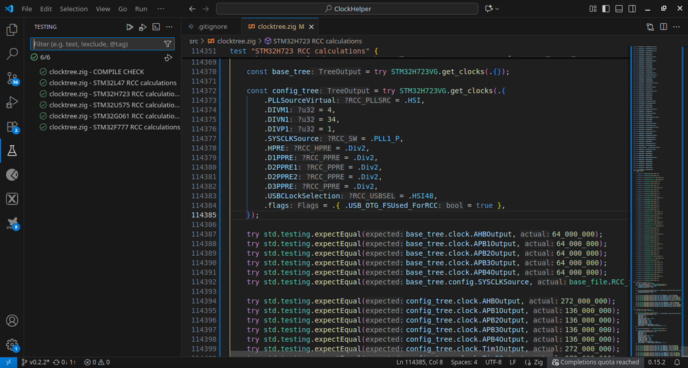

Without direct access to CubeMX code generation, configuring and validating clocks becomes quite tedious — you often end up going back and forth with the tool just to make sure each change is still valid, checking VCO limits, prescalers, and so on. This is where my experiments with ClockHelper come in: it started in Zig, but Rust and other languages are also on my radar.
The idea behind the library is to embed a good portion of CubeMX’s clock configuration logic, but using zero/low-cost abstractions. By leveraging compile-time mechanisms available in many modern languages, it becomes possible not only to compute the full clock tree at compile time, but also to eliminate any runtime overhead that would normally be involved.
It’s still far from being complete or production-ready — more of an ongoing exploration — but it’s already usable in some real scenarios.
The examples below use STM32H723 as a base, but I’ve also tested targets like STM32U575 and STM32F777, as well as simpler families like C0, F1, and F3.

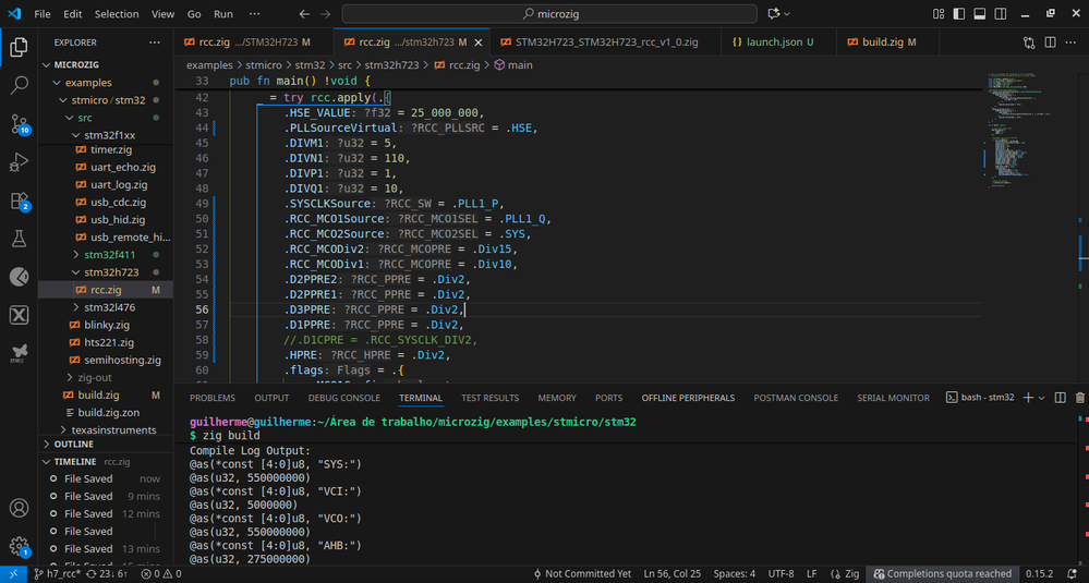

One of the first tests was validating clock calculation and verification across multiple domains.
Starting with the “happy path”, using a valid configuration — just checking that all computed values match expectations:
Nothing too surprising here: the calculations are correct, everything behaves as expected.

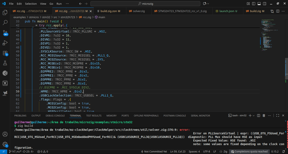

For example, taking a configuration targeting ~550 MHz on the STM32H723:
Everything looks fine — now let’s start breaking it on purpose:

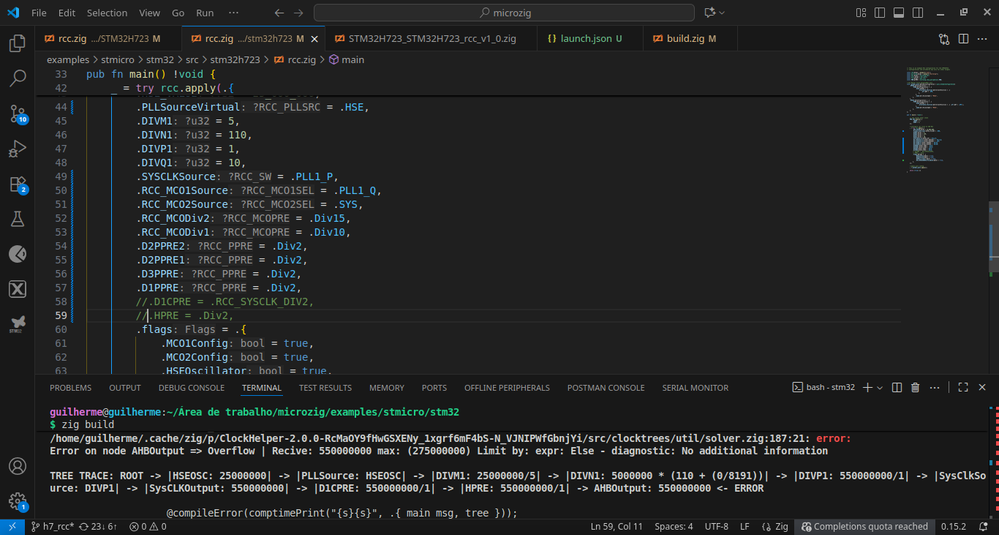

Removing the AHB prescaler (HPRE) causes the frequency to exceed the allowed limit:

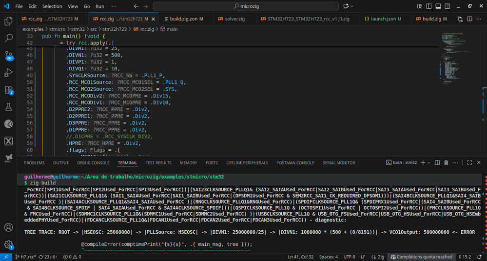

Enabling USB and selecting the PLL as its source, but not using HSE as the PLL input:
In this case, the validation ensures that when the PLL is used as the USB clock source, its input must be derived from HSE — otherwise the configuration is considered invalid.

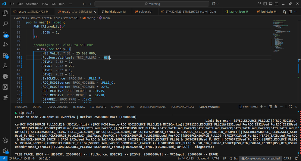

Another interesting case is the relationship between VCI (PLL input) and VCO:
By adjusting the input divider (M), it’s possible to push the VCI out of its valid range, which in turn invalidates the VCO — even if the final frequency might look correct at first glance:
This kind of issue is particularly tricky to catch manually, since it involves multiple stages of the PLL at once.

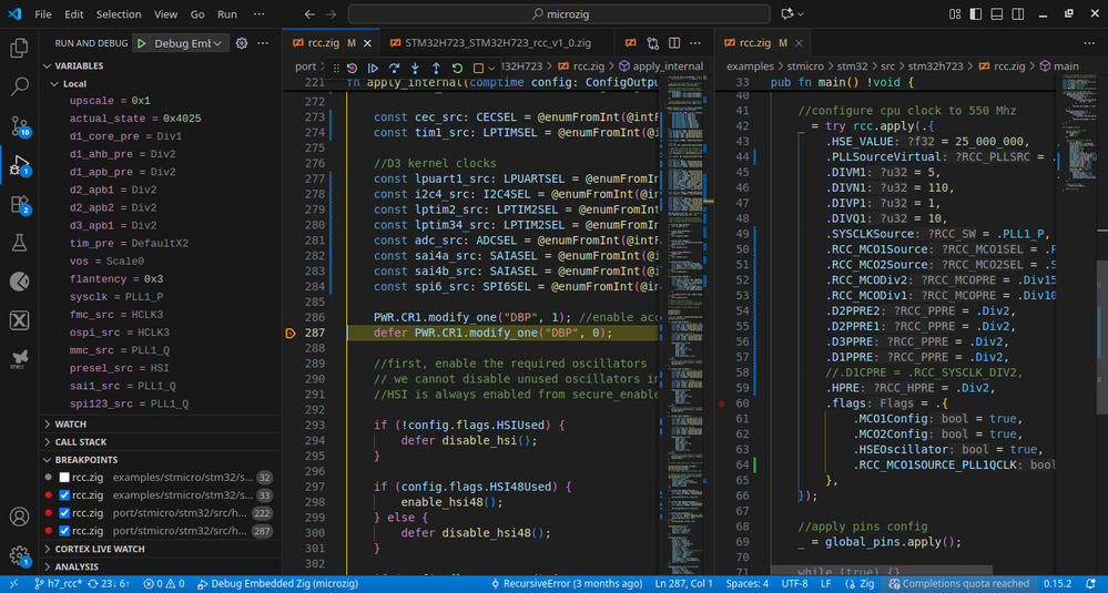

Finally, even parameters that are not explicitly configured — such as VCI/VCO ranges, VOS, and flash latency — are automatically derived based on the current clock configuration.
The idea is that once the clock is defined, the rest of the system adjusts itself to remain within valid operating limits, without requiring manual tuning of every parameter.
In addition, by using data from the embassy / stm32-data project, most of the generated values are bit-accurate with the hardware, making the setup essentially plug-and-play when applied to registers.

So, assertions.
There are many ways to skin a cat.
Why not use c++ for this? constexpr and consteval are very useful for this

My choice of Zig is purely personal for this testing phase; if everything works, I intend to create versions for other languages ​​that also have comptime mechanisms.
