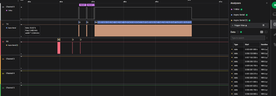

Here is a screen shot what Retriggerable pulse looks like.
Channel 0 is Retriggerable timer pulse

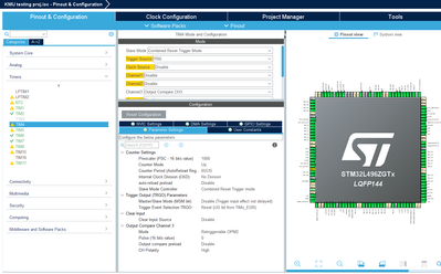

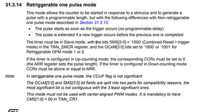

So according to datasheet it is said that the timer needs to be in combined reset + trigger mode .
So in cubemx i selected following options
in case of my initialization code i changed the period value to 1ms pulse

Describe, what do we see on that captured waveform, and how is it different from the expectations.
Read out and check/post content of TIM registers.
ignore the first pulse as it is just from reset and some noise
as you can see from pulse in red circle. i invoked the timer trigger once but after that i could not  trigger it and timing was also not what I set.
