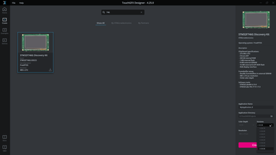

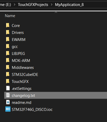

GaetanGodart
Hello @JStei.6 ,
There is a new revision of this board.
https://community.st.com/t5/stm32-mcus-touchgfx-and-gui/touchgfx-not-working-stm32f746g-disco/m-p/730922#M39973
Since you are using an old version of the board, you should use an old version of the TBS.
You can change the TBS revision here:
However, I am unsure which version you need.
You can look at the changelog to see what has changed and which TBS will be compatible with your board:
Regards,
Gaetan Godart
Software engineer at ST (TouchGFX)
