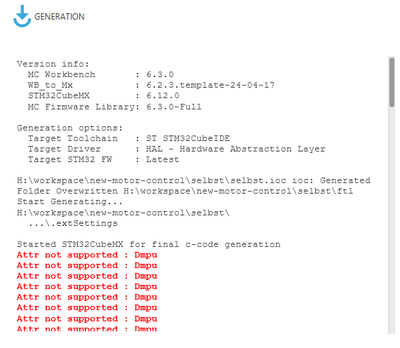

So I have download and install software X-CUBE-MCSDK. After starting of this I can select the correct hardware. But afte start the generation of the source code I become a error:
How can I solve it? Which package must I install in STM32CubeMX? I dosn't found a package for this.

Now I have check the same with the newer version X-CUBE-MCSDK-6. But here I become other errors during the generation:
GMA
Hello @bm2,
As mentioned in this post, do not take into account this error and if generation reaches main.c file, please proceed with generated project.
