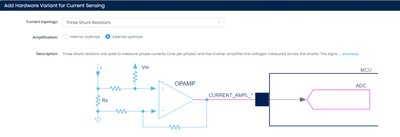

[HOW TO REPRODUCE]:Try to use the board designer and configure a current sensing feature, the only option available when working with external opamps is the setup with a non-inverting opamp.

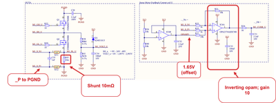

This is our opamp circuit:
I wanted to have the model of it put into the Board Designer in order to use the workbench for our initial project generation but I'm unsure how to apply the fix for the inverting opamp circuit that we have?

Hello @Zeno,
I looked at your schematic. In your case the parameters are the following:
Polarization offset = 1.65V
In your case Offset attenuation = 1
Opamp gain = -10

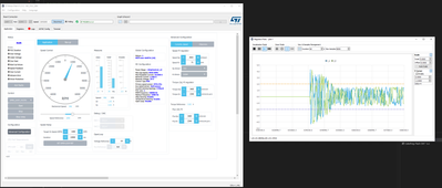

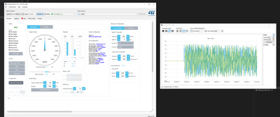

Currently tried runningn open loop to see how the MCSDK is handling the current sensing so I plotted phase a and phase b.
At 100 rpm Vref of 20% gave me these results:
At 1000rpm Vref of 20% gave me these results:

Hi @cedric H
Thanks for the reply, looks like I'm using that parameterisation for the opamp circuit but I did also set the
Amplifying network reference (Vm) * to 1.65V.
Is that correct?
With kind regards,
Zeno
Hi @Zeno ,
No, it is not correct. It should be 3.3V
Regards
