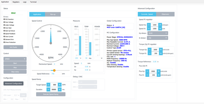

Hello everyone,
I'm working on a proposal for an STM32 MC SDK AC Induction Motor using the STEVAL-IHM023V3, NUCLEO-G431RB, and NUCLEO-IHM09M1 boards in the development environment. I've encountered some challenges while setting up the project and testing.
Setting Up LSO Gains
While creating the project in MC Workbench (MC WB), I came across some variables whose values I'm unsure about, such as the KP and Ki gains for the LSO observer. The ST documentation mentions a general gain range of 1-1.5 for the observer, but it doesn't provide information about the controller bandwidth or how to manually edit KP and Ki.
Current and Speed Controller Gains
Based on my understanding of FOC loop theory, I estimated the KP and Ki values for the speed and current controllers. However, during testing with Motor Pilot, it seems the values have specific units, and I'm unsure how to adapt my values to them (see attached image).
Experimental Issues
Using some estimated values, I was able to build the project. However, in most cases, I've encountered stability issues when the current and speed Ki values are non-zero. Additionally, the observed speed doesn't match the actual speed. Furthermore, if the motor attempts to reach its nominal speed (around 1700 rpm), instability occurs upon reaching that speed, with errors like "speed feedback error" or "overcurrent error" appearing in Motor Pilot.
NOTE: I understand that some of these problems might be related to the motor's electrical parameters. However, it's important to note that these parameters weren't obtainable through the profiler because it's unavailable for these boards. I had to rely on experimental testing and estimations to obtain them.
Finally, I would greatly appreciate any information or suggestions you might have to help me troubleshoot these issues.

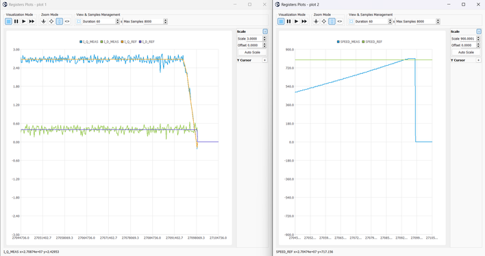

I’m working with a motor running at 1750 rpm, 0.37 kW, and 1.94 A @ 220V. I was able to get a current probe and a tachometer to tune the current controllers, but I’m having some problems tuning the speed controller and the observer parameters.
Using the tachometer, I compared the real speed with the observed speed and found a difference of around 50 RPM during acceleration but the main issue is that when the observed speed reach the target speed, iq is reduced (as part of the control loop) to regulate the speed,  however even when the real speed of the rotor is reduced (measured with the tachometer) the observer does not register this change and think the speed is still high therefore keeps reducing iq ref until the motor stop but the observer is still obtaining a wrong speed and then the control loop gets out of control.(See images)
I think that i have a problem with the observer Kp/Ki and/or K gain, but i have tried different values but i was not able to fix it. I would greatly appreciate any suggestions  to help me troubleshoot this issue.

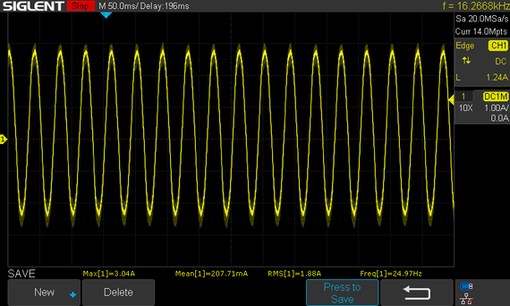

Additionally, I tuned the current controller, and the waveform I obtained is as follows:
Does this look good to you? Let me know if you need any more changes!
September 4, 2024
Hello @carlos_gtronix
From the screenshot it seems the current waveform is smooth without any jitter/noise; you may even try to increase the Kp/Ki of the current controllers (same values for Iq/Id for instance).  Anyway, that is not your main concern for the time being. Are you using a custom motor prototype, is the datasheet available somewhere on the net?
Regarding the sensorless observer, it relies on its gain settings but also the correct entry of the motor parameters so that the estimate of the rotor speed can be rebuilt on the most accurate mathematical model of the motor.
Have you updated the file acim_motor_parameters.h that contains the parameters to customize the sensorless estimator to your application?
#define LM ((float)(0.1485)) /* Motor Magnetizing inductance (Dynamic model), (H) */
#define LR ((float)(0.1515)) /* Global rotor inductance (Dynamic model), Lr = Llr + LM, (H)*/
#define LS ((float)(0.1515)) /* Global stator inductance (Dynamic model), Ls = Lls + LM, (H)*/
#define TAU_R ((float)(0.2164286)) /* Rotor Time constant, Lr/Rr, (s) */
#define TAU_S ((float)(0.0688636)) /* Statot Time constant, Ls/Rs, (s) */
#define SIGMA ((float)(0.0392118)) /* Total leakage factor, (dimensionless)*/
#define POLE_PAIR_NUM 1 /* Number of motor pole pairs */
#define RS 2.2 /* Stator resistance , ohm*/
This file contains by default the parameters for a legacy SELNI motor that is for sure different from the one you are using.
For instance, and as mentioned in my previous post, I would suggest to run your system with the tachometer giving the speed feedback of the rotor (so your system runs with the tacho sensor in sensor mode, not sensorless). Once running smoothly with the tacho sensor, you shall run the sensorless algo observer in parallel and monitor its output (still in sensor mode but with the sensorless code executed): from there you can check the actual rotor speed given by the tachometer and the rotor speed estimate given by the sensorless algo (to be tuned by updating the algo gains and probably the values in the file acim_motor_parameters.h). That will allow you to make sure the sensorless algo is running smoothly once the rotor speed estimate will be in line with the tacho speed physical sensor.
Please note also that at very low speed and low load (<>0 RPM <>0 current), it is where the sensorless algo is the most challenged : you may experience slight differences between the tacho feedback and the sensorless algo.
