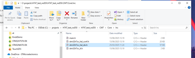

2025-06-13 4:39 AM
Hello @vijay29489 ,
It seems that DSI is defined but there must be a confusion in the naming because it DSI being defined doesn't mean that DSI is enabled but only that the address is known.
Which means that it tries to include the DSI header which you don't have if you disable DSI in STM32CubeMX.
So a fix is to add the DSI header (please find it attached) to your Core => Inc folder :
We will investigate internally to fix this issue, thank your for bringing it up.
Regards,
Software engineer at ST (TouchGFX)
2025-06-17 11:11 PM
Hi Gaetan,
Thank you very much for promptly sharing the dsi.h file and the corresponding fix — that part is now working well.
