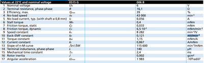

I am currently working with a motor that isn’t compatible with the motor profiler, so I need to manually input the motor parameters provided in the data sheet.
The data sheet specifies the following values:
- Rs (phase-to-phase) = 16.1 ohms
- Back EMF constant = 0.121 V/Krpm
- Ls (phase-to-phase) = 0.140 mH

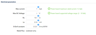

To correctly enter these values in the configuration, should I input them as:
- Rs = 16.1 ohm
- Ls = 0.140 mH
- Back EMF constant = 0.121 Vrms/Krpm ?
Or is there a different approach or format I should follow when inputting these parameters?

Also, be aware that the values of R and L given in your motor's datasheet are phase to phase, which does not correspond to Rs and Ls : they should be two times lower than what you have.

Could you confirm if the Back EMF constant of 0.121 V/kRPM in the documentation is given as V_peak/kRPM and should be converted to Vrms/kRPM (0.121 ÷ √2 = 0.0856 Vrms/kRPM) for use in the workbench?
Additionally, are the following values correct?
- Rs = 8.05 Ω (phase-to-phase ÷ 2)
- Ls = 0.07 mH (phase-to-phase ÷ 2)
- Back EMF constant = 0.0856 Vrms/kRPM
Thank you for confirming.
