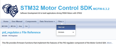

On STEVAL-PTOOL4A board, you can try the High Sensitivity Observer (HSO) for low speed. Refer to "HSO Startup Guide" available through "Workbench tool">About>Documentations>Documentation".
On the other hand, still using FOC/HALL sensor use case, if a set of PID parameter could cope with your High Speed use case and another set with Low Speed use case, you can change these PID parameters dynamically (as you can do through Motor Pilot Advanced Configuration setting).
PID_Setxx() functions located in pid_regulator.c file.
More detail in:
Best regards.
