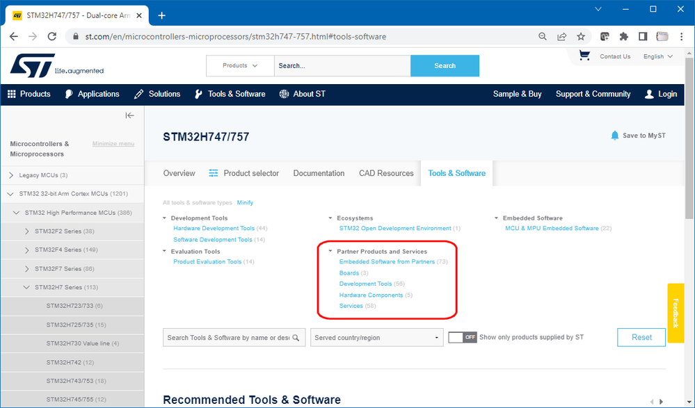

I'd start here:
another point, commercial version TCP/IP stack may have better performance.
But you have to correctly use it. otherwise you will get similar throughput.
