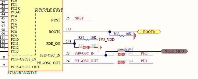

Also I  am wondering. The board doesn't seem to have a quartz. I tried two nights configuring but had lots of jitter / drifting clocks.

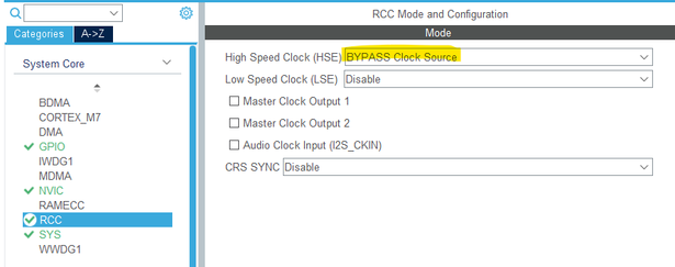

If you are using a NUCLEO-H753ZI then there are no external crystals but there is the MCO clock from the ST-Link.
You have to set up for High Speed Clock HSE

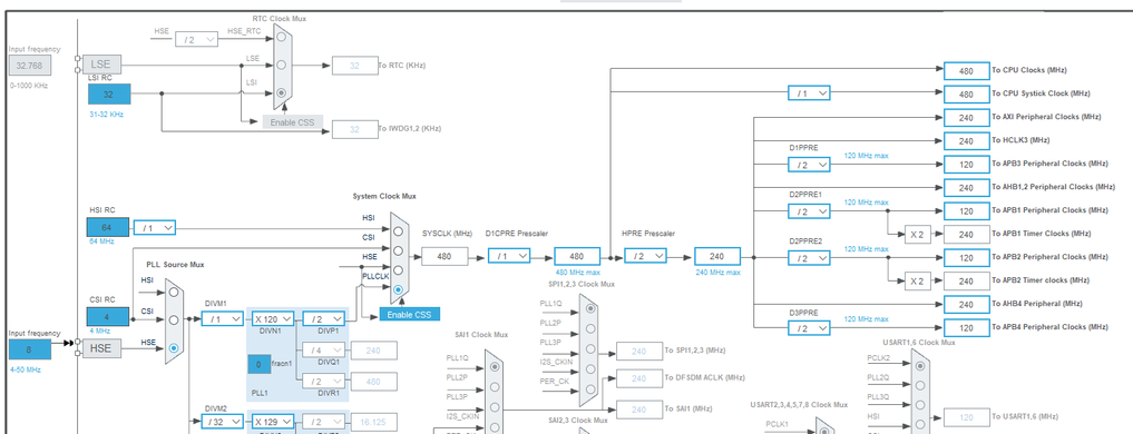

Only the CPU clock can run at 480MHz. The peripheral clocks can only run at 240/120MHz.
