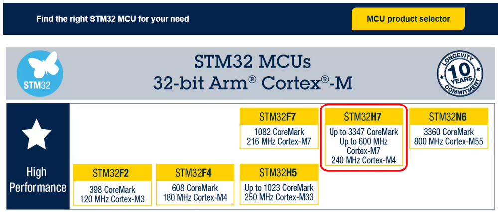

Overview of the STM32 Microcontroller range here:
https://www.st.com/en/microcontrollers-microprocessors/stm32-32-bit-arm-cortex-mcus.html
You can see that STM32H7 is the dual-core family
https://www.st.com/en/microcontrollers-microprocessors/stm32h7-series.html

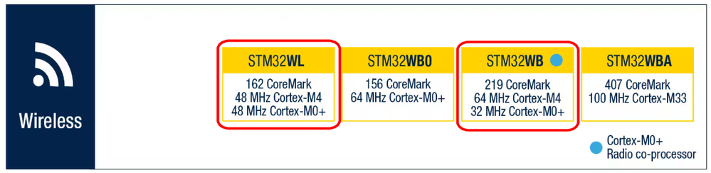

@STbeginner wrote:
  • Over The Air programming: Yes
So you want a radio?
Options there are:
But they may not fit your other criteria.
