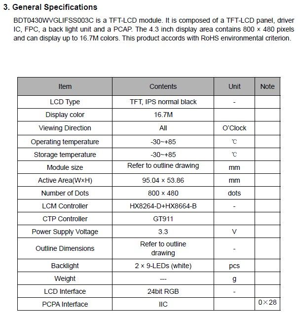

Do you have any video of this "flicker and glitch"? (as there are many different types of artifacts, each with their own causes and solutions)
Could there have been any power dip?
What exact display do you use?
Could there be memory corruption due to stack/heap overflow?
Please format your code: https://community.st.com/t5/community-guidelines/how-to-insert-source-code/ta-p/693413
Kudo posts if you have the same problem and kudo replies if the solution works.
Click "Accept as Solution" if a reply solved your problem. If no solution was posted please answer with your own.
Thanks for the quick reply. Here are the details you requested
Video of the LCD flicker: https://youtube.com/shorts/UvEyO2nkvlU
We can confirm that there is no power dip and memory corruption due to stack/heap overflow
Here are the display specifications:
Display module number: BDT0430WVGLIFSS003C
Display specificationsDisplay specifications
Thanks
Looks like H-sync/V-sync issues. It could be you are driving the display just outside of its specs and it will work for a while and then stop working (temperature changes? frequency drift?).
Look at H-sync/V-sync pulse widths and the length of your porches( horizontal front and back porch and vertical front and back porch).
If you find the values are out of spec this is probably the cause. You could try to make it worse in order to try to reproduce the problem easier.
Issue could also be that the internal data bus is overloaded causing a type of tearing. Is the SDRAM cached?

Fairoosali
You seem to be correct, our H-sync and V-sync values were not aligned with the display panel specifications. We’ve corrected them and will perform a trial run to confirm the fix.
