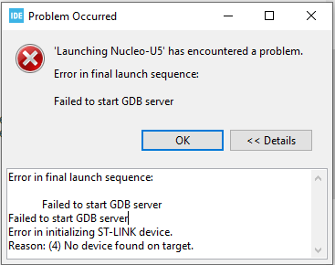

Impossible to launch the debugger with the following configuration:
  • STM32CubeIde1.7.0
  • Target Nucleo-U575ZI-Q
  • ST-link :
  1. Version: V3J8M3
  2. Build:  Apr 9 2021 20:49:40
See log files
STm32cubeProg 2.8.1 can connect to the board successfully.
What is wrong ?
BUG ?

maybe you didnt closed the STM32CubeProg session so the gdb server is busy? it happens to me sometimes

0693W00000GWFHpQAP.pngI admit that I have also made this mistake more than once, but not in this case.

Can you try to decrease the STLink SWD frequency.
If not better, can you try with OpenOcd gdb server.

Indeed, decreasing the frequency of the St-link seems to improve the connection, but it is not very stable.
The frequency of successful connection varies between 8Mhz and 21Mhz !
I have not encountered this problem on other Nucleo board references.
Regards

Stay below the 8MHz as specified in the errata: https://wiki.st.com/stm32mcu/wiki/STM32CubeIDE:STM32CubeIDE_errata_1.7.0#STM32U5
The lower the better stability.
