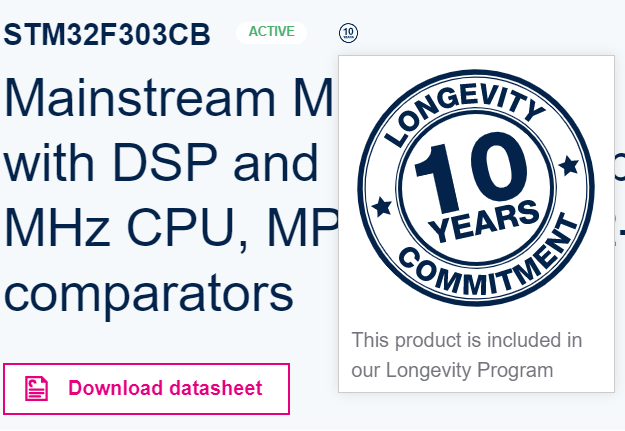

Imen.D
Hello @CRami.3​ and welcome to the Community :)
This product appears in the list of selected products for the 10 years Longevity commitment (link).

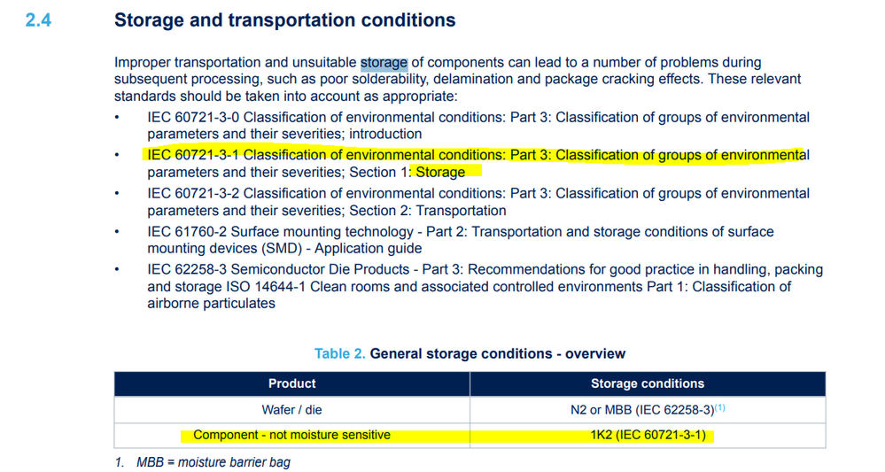

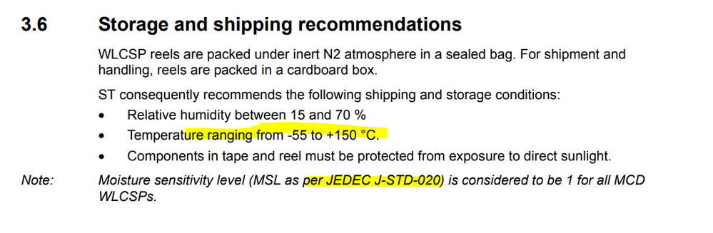

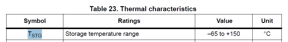

Imen.D
I'm looking into your request, but I only found the temperature conditions in the device datasheet.
There is also the storage and transportation conditions in the TN1224 and TN1163, but I can't find info on the maximum storage duration.
0693W00000GWuU5QAL.png0693W00000GWuWfQAL.pngImen
