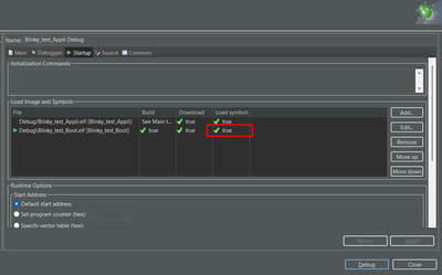

I followed this STM32CubeIDE tutorial to debug an STM32H7S3L8 project running from external flash (OSPI NOR). After flashing and starting the debug session, I get the following error:
Break at address "0x8000B2C" with no debug information available, or outside of program code.

Hi @MHoll.2 ,
Enabling the "Load symbols" option has resolved the initial issue.
However, there's a new issue with the code generated by CubeMX. It seems to get stuck at the SCB_EnableDCache() function for a while before jumping to the Error_Handler(void). I suspect there might be a configuration problem with the template code for the NUCLEO-H7S3L8.

MHoll.2
Senior III
0x08000B2C is in the internal user Flash, so You probably have some problem inside the bootloader (who init's the OSPI Flash).
What happens if You click run?
Duc
Hi @MHoll.2 ,
