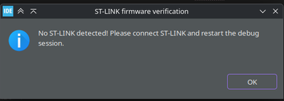

I'm trying to work with a STM32F4-Discovery board, and previously it connected perfectly okay, but a couple weeks ago something, seemingly out of nowhere, broke and CubeIDE stopped detecting the board and writing programs to it showing this message:
I tried reinstalling the IDE, downgraging the toolchain, upgrading the IDE, creating a fresh project and so on.
I'm running version 1.19.0 CubeIDE, using EndeavourOS (Arch-based).
Here are my udev rules for a relevant device:
# stm32 nucleo boards, with onboard st/linkv2-1
# ie, STM32F0, STM32F4.
SUBSYSTEMS=="usb", ATTRS{idVendor}=="0483", ATTRS{idProduct}=="374b", \
    MODE="660", GROUP="plugdev", TAG+="uaccess", ENV{ID_MM_DEVICE_IGNORE}="1", \
    SYMLINK+="stlinkv2-1_%n"
SUBSYSTEMS=="usb", ATTRS{idVendor}=="0483", ATTRS{idProduct}=="3752", \
My user is a member of the plugdev group.
 But the important detail is that if I run `stm32cubeide_wayland` as root through `sudo` it is able to detect the board. (Still doesn't run the project, but that's because I don't have it setup for root either way.)
