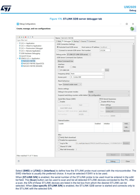

I got this (since I have multiple STLINKs attached):
Where do I specify the serial number in the command line (of the gdb server) ?
STTwo-32
Hello @chriskuku
to select a specific ST-Link will connecting multiple ST-Link to your machine, you have to follow the last paragraph of the page 160 of the  UM2609 together with the figure 176:
Best Reagrds.

STTwo-32
Hello @chriskuku
Best Reagrds.
STTwo-32
Thanks. I see this configuration option in the ST-LINK(ST-LINK GDB server) setup but not in the ST-LINK (OpenOCD).
This option is not available in openOCD debug probe.
Best Reagrds.
STTwo-32
Best Reagrds.
STTwo-32
Can it be circumvented by giving OpenOCD a command line option or edit a config file?
This is not available using the SMT32CubeIDE.
Best Regards.
STTwo-32
