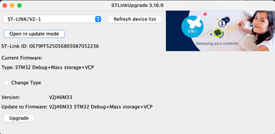

Thanks. Target only has four pins to connect to SWD: 3.3V,SDIO,SCLK,GND.
I don't see an option "connect under Reset" in the debugger setup pane.
STLINK/V2 is the latest, I believe:
I did a mass erase chip under STM32CubeProgrammer and connectioin now worked. Could debug into the program.
