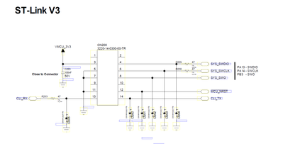

I am experiencing a consistent connection issue with my development setup:
Hardware/Software Configuration:
  • MCU: STM32 (exact model: STM32G474VET6)
  • Debugger: STLINK-V3
  • IDE: STM32CubeIDE
  • Programmer: STM32CubeProgrammer
  • Operating System: Window
  • Target board : Custom board
    • art of custom board schematics :
Problem Description:
  • When connecting my STLINK-V3 to STM32CubeIDE, the IDE fails to detect or connect to the target device. It typically shows error messages like “No ST-LINK detected” or “No target found.”
  • However, when I use STM32CubeProgrammer, the STLINK-V3 is detected and connects to my target MCU without any issues. All programming and memory read functions work perfectly.

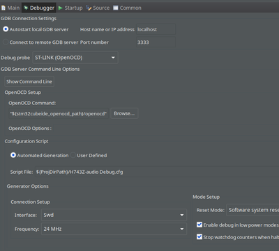

AScha.3
>  While many boards face connection issues with STLINK-V3 in STM32CubeIDE, some boards succeed to be connected.
The IDE checking the cpu is "genuine STM" , so it refuses connect on all cpus that might be not from STM.
CubeProgrammer connects -if possible- also to other ARM cpus.
But here , on (i assume) genuine STM32G474VET6 , it should connect also in IDE .
Maybe try: set debug to using openOCD  (i had some strange "no target.." , but switching the debug to OCD - it works.  And even switching back the debug setting, it works. This happened also on boards, working before....and then also working again. So dont ask me "why" .)
so try: (and adjust the settings...see:)
