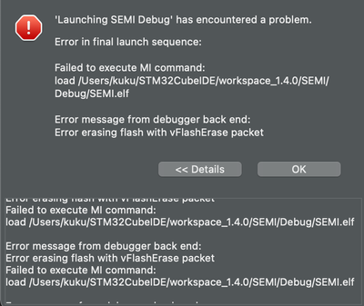

I'm trying out semihosting with openocd in STM32CubeIDE.  For this purpose I added the call
initialise_monitor_handles();
in main.c as the second call after HAL_Init();
I have STLINK(gdb server) configured. The program goes into that call (initialise_monitor_handles) but never returns.
Trying OpenOCD gives another error:

3 REPLIES 3
Ghofrane GSOURI
Hello @chriskuku
To enable semihosting for printf and similar functions on your STM32H5 device using STM32CubeIDE and OpenOCD, first ensure you call initialise_monitor_handles() after HAL_Init() in your code. In STM32CubeIDE, open your debug configuration, go to the Debugger tab, and in the OpenOCD Options field, add -c "arm semihosting enable" -c "arm semihosting_fileio enable". This configures OpenOCD to handle semihosting calls, allowing your program’s output to appear in the debugger console.
More details could be found in OpenOCD User’s Guide
THX
Ghofrqne
I'm getting:
Open On-Chip Debugger 0.12.0+dev-00623-g0ba753ca7 (2025-04-30-14:20) [https://github.com/STMicroelectronics/OpenOCD]
Licensed under GNU GPL v2
For bug reports, read
	http://openocd.org/doc/doxygen/bugs.html
Unexpected command line argument:  -c
Maybe I had some typo in specifying the -c flags. Anyway, this time the error message from OpenOCD is different::

Error: The 'arm semihosting' command must be used after 'init'.
Hello @chriskuku
Based on the error message, we need to ensure that the semihosting commands are executed after OpenOCD has been initialized. To do this, enter the following in the OpenOCD Options field:
-c "init" -c "arm semihosting enable" -c "arm semihosting_fileio enable"
If you continue to encounter errors, carefully check for any typos or unintended spaces in the options field. Make sure each command is enclosed in its own set of double quotes
THX
