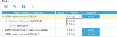

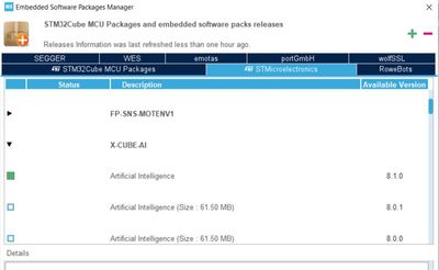

I see that v8.1 was released and I am trying to import it into STMCubeMx, but it doesn't appear to be a recognized/available package.
I manually installed it off the ST website and see it being recognized by the package manager
But, it is not available for project configuration
Is there a step I am missing here?
Thanks!
I have exact the same problem. Did you solve it yet. If so, can you describe your solution.
JLojo
Hi Guray1
As described above, just:
  • Copy from the repository STM32Cube\Repository\Packs\STMicroelectronics\X-CUBE-AI\8.0.1\Middlewares\ST\AI\Inc to your workspace.
  • Remove ':NetworkRuntime801_CM4_GCC.a' from Project/Properties/C/C++ General/Paths and Symbols/Libraries.
Only problem: you need to redo this each time you regenerate!
