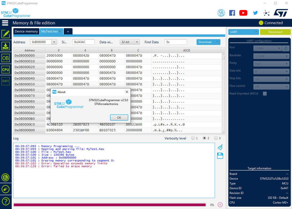

ST32L081 can not be programmed with firmware bigger than 128k with CubeProgrammer and UART-Bootloader.

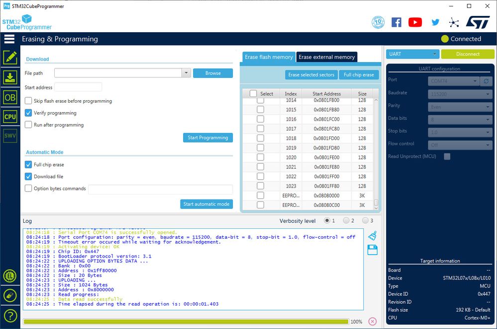

I think there is something wrong with erase. In the "erase flash memory" tab the "last" start address is 0x801FF80. With that there will be nothing erased above 128k

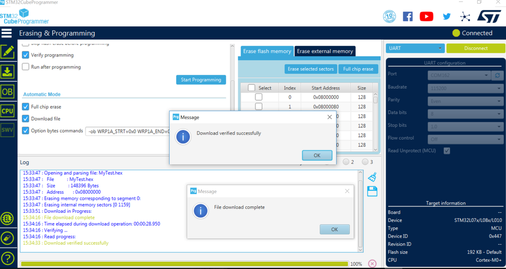

When programming same file with ST-Link it works just fine.

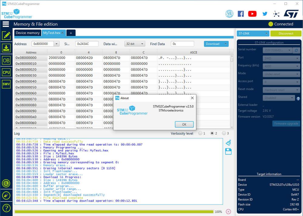

Tested with 192KB samples with CubeProg 2.5.0 and no issue found.
We are able to program with exactly the same file size as the customer with both ST-LINK and UART interfaces.
Please specify the ID of the Bootloader version.
